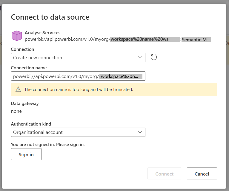

Clicking configure connection brings up the connect to data source window. I have already selected organizational account in the screenshot:
step1

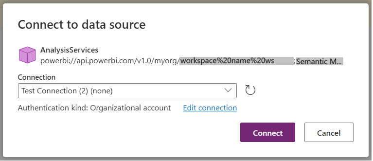

After clicking Sign in and choosing my account, I get the following. I have authenticated successfully to the semantic model. (I also changed the connection name beforehand).
step2

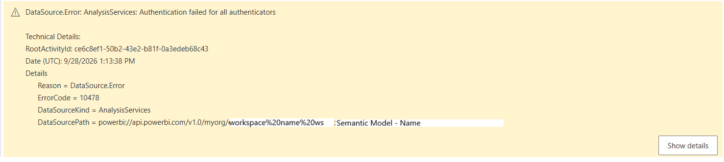

I then click connect, but I get the "Authentication failed for all authenticators" error:
step3

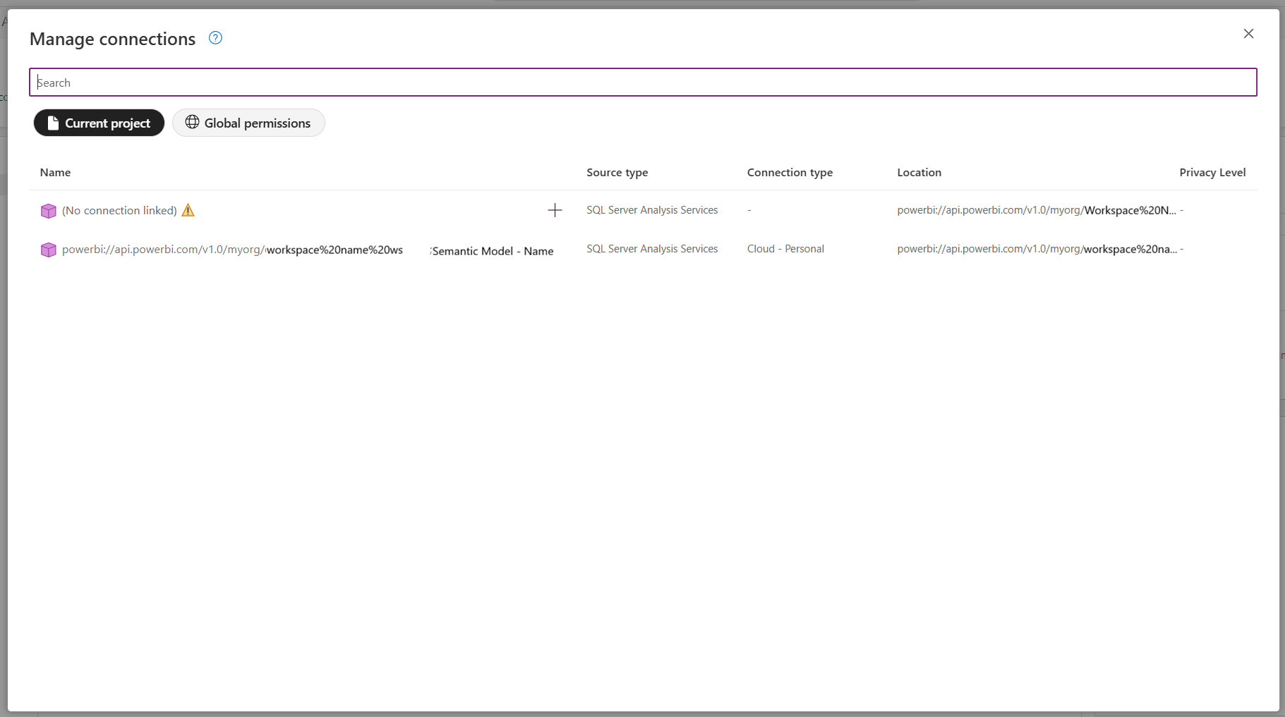

Clicking manage connections shows the following. The reason I wonder whether the casing is important is that there are two lines, with two different locations. The one with the correct title-case workspace name shows as (no connection linked) and the newly created connection is on a separate line in lower case.
The top line has the tooltip "This data source is present in your mashup, but has no credentials available". The bottom line has the tooltip "This data source is present in your connections but not used in this mashup".
connections
This all implies to me that for some reason the connection is not being correctly bound within the query. Any assistance sorted this out would be appreciated.
