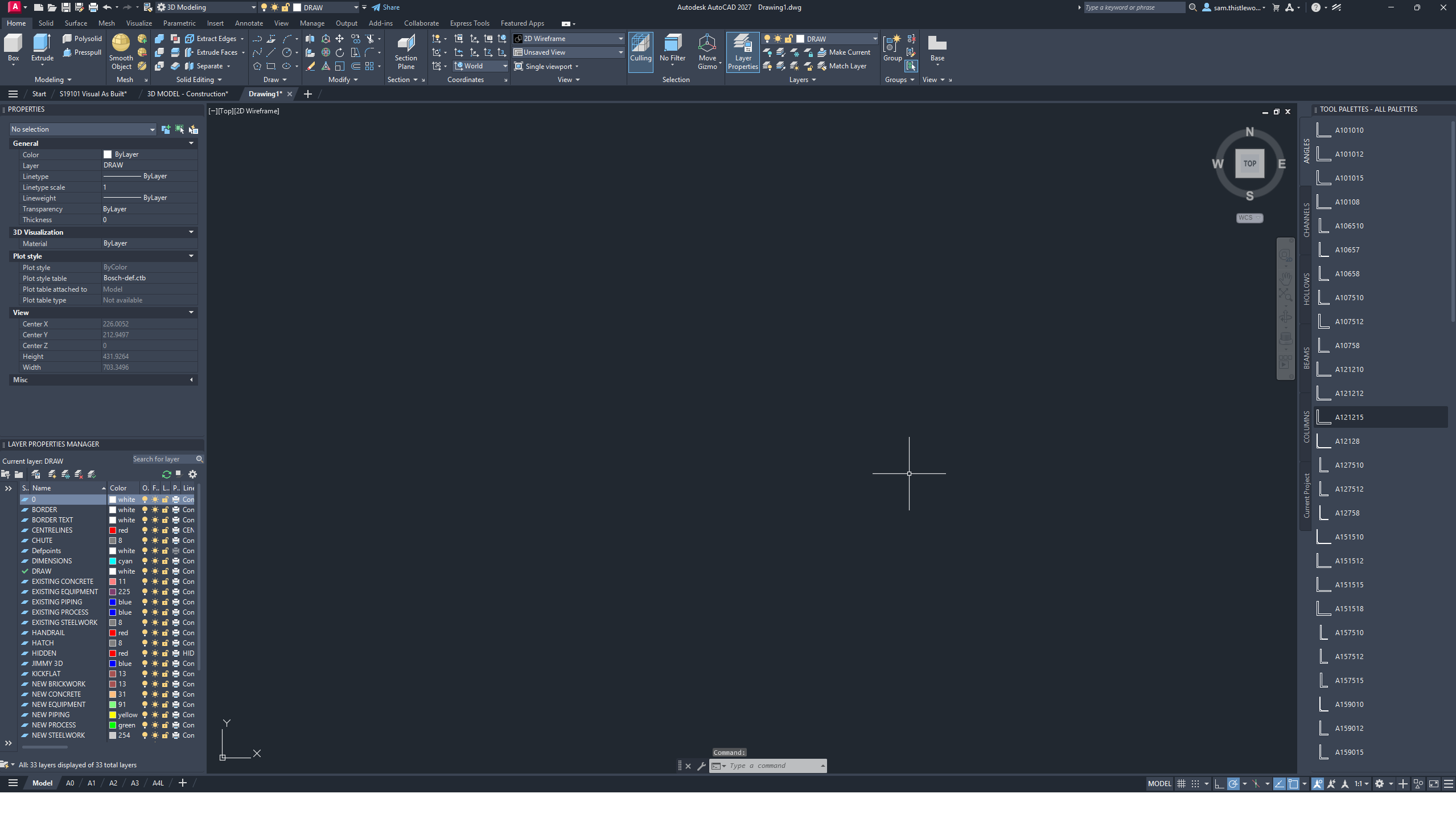

The Windows 11 Taskbar randomly goes completely white. I have to use the Windows key for it to go back to normal and to be able to use Taskbar icons.
I can't see a pattern relating to what apps are open at the time.
Any advice on a fix?
Screenshot 2026-10-08 091712
