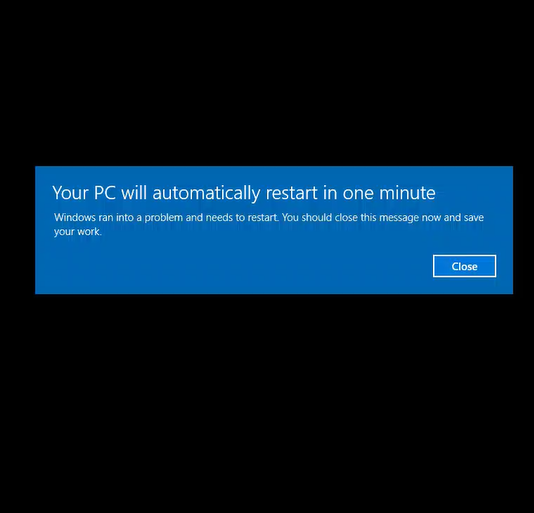

Error login to Azure Remote Environment (Automatically Restarting Server)
Bhashura Perera 0 Reputation points
2026-09-28T06:30:34.9366667+00:00
Issue
This error occurs for users when logging in every time.
Any solutions?

    The screenshot indicates a Windows guest OS restart, not primarily an Azure/RDP connection issue. Because it happens when users sign in, first determine whether a critical Windows process is failing.
