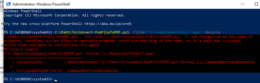

How do I fix this error when trying to convert all Publisher files to pdf?
.\Convert-PubFileToPDF.ps1 : The term '.\Convert-PubFileToPDF.ps1' is not recognized as the name of a cmdlet,
function, script file, or operable program. Check the spelling of the name, or if a path was included, verify that the
path is correct and try again.
At line:1 char:1
  • .\Convert-PubFileToPDF.ps1 -Filter "C:\PublisherFiles*.pub" -Recurse
        + CategoryInfo          : ObjectNotFound: (.\Convert-PubFileToPDF.ps1:String) [], CommandNotFoundException
        + FullyQualifiedErrorId : CommandNotFoundException

That error is occurring before the script runs. PowerShell cannot find Convert-PubFileToPDF.ps1 in your current directory.
First, check where PowerShell is currently looking:
Get-Location
Then check whether the script is actually in that folder:
Test-Path .\Convert-PubFileToPDF.ps1
If that returns False, change to the folder containing the script. For example, if you saved it in C:\Scripts:
Set-Location C:\Scripts
Then verify:
It should return True. You can then run:
Alternatively, specify the complete path to the script without changing directories:
C:\Scripts\Convert-PubFileToPDF.ps1 -Filter "C:\PublisherFiles*.pub" -Recurse
If the script is downloaded from the Internet and Windows has blocked it, you may also need:
Unblock-File C:\Scripts\Convert-PubFileToPDF.ps1
Then run it again.
One other possibility is that the file was saved with a different extension, such as Convert-PubFileToPDF.ps1.txt. Check with:
Get-ChildItem C:\Scripts\Convert-PubFileToPDF*

    CommandNotFoundException means PowerShell cannot find .Convert-PubFileToPDF.ps1 at the path being used.
    Try this:
    1. Verify the script file actually exists in the current folder.
      • .Convert-PubFileToPDF.ps1 only works when the script is in the current working directory.
      • Check the current directory path with:
             Convert-Path .
    2. If the script is in a different folder, run it by full path instead of .Convert-PubFileToPDF.ps1.
      • Example pattern:
             C:\Path\To\Convert-PubFileToPDF.ps1 -Filter "C:\PublisherFiles\*.pub" -Recurse
    3. If the path contains characters that should be treated literally, use the exact script path.
      • PowerShell cmdlets such as Publish-Script distinguish between -Path and -LiteralPath; -LiteralPath does not support wildcards. This is useful when working with exact paths.
    4. Confirm the script name is spelled exactly right, including the .ps1 extension.
    5. If the script was downloaded for bulk conversion, make sure it was downloaded to the machine before running it. The bulk conversion guidance requires downloading the sample script, then running it against the files or directories needed.
    For the Publisher bulk conversion scenario, the documented usage pattern is:
    Convert-PubFileToPDF.ps1 -Filter "C:\Documents\*.pub" -Recurse
    That command assumes the script file is already present in the location from which PowerShell is being run.
