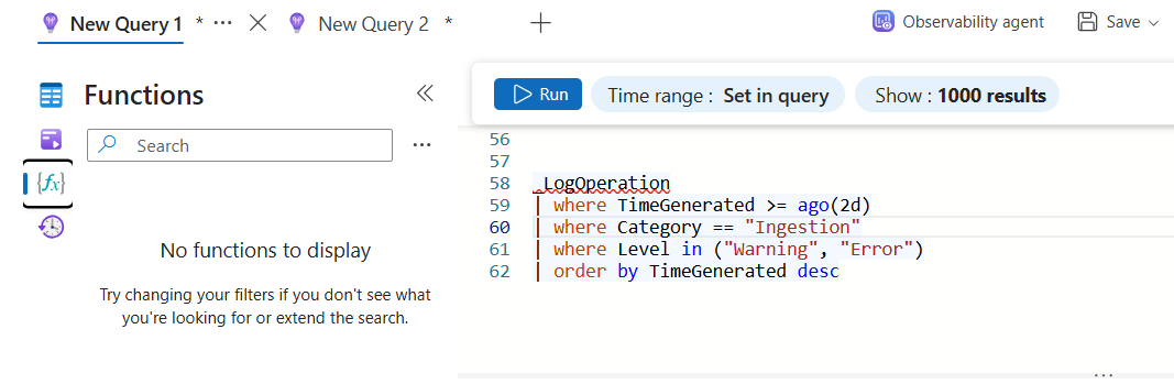

    Check ingestion status directly
    Run this query in the workspace:
    _LogOperation
    | where TimeGenerated >= ago(2d)
    | where Category == "Ingestion"
    | where Level in ("Warning", "Error")
    | order by TimeGenerated desc
    This is the documented way to check ingestion health. If you see warnings or errors around the same time each day, that confirms the cap is being hit.
