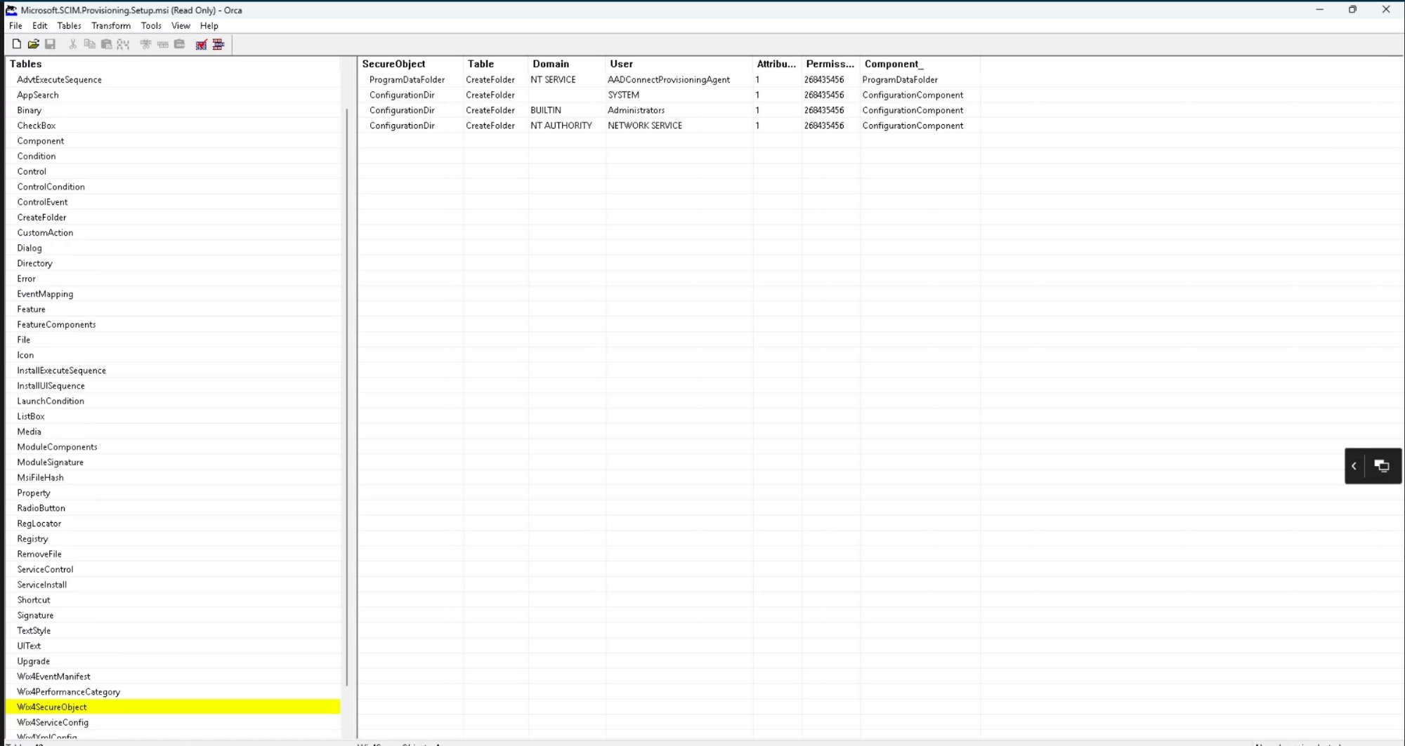

  1. EFR 0 Reputation points
    2026-10-07T10:35:33.5933333+00:00
    German Server here too. I resolved it by using orca. The error is, that the msi is using the english group/user names. Why Microsoft can't use parameters that resolve globaly and is using english localisation is beyond me.
    Here a screenshot from Orca:
    User's image
    I resolved it by building a transformation file with deleted Domain and correct Username.
    You also need the msi File. I can't upload them here i suppose.
    Path to resolve:
    While the installaer runs at AppData\Local\Temp there will be folder created with the msi file in it, copy it out of it, before the roll back deletes it.
    Use Orca to create a transformation File with working usernames
    Run the msi file with the transformation file for example:
    msiexec /i "C:\Temp\agentlayout\Microsoft.SCIM.Provisioning.Setup.msi" `
    TRANSFORMS="C:\Temp\fix-accounts.mst" `
    /l*v C:\Temp\agent_mst.log
