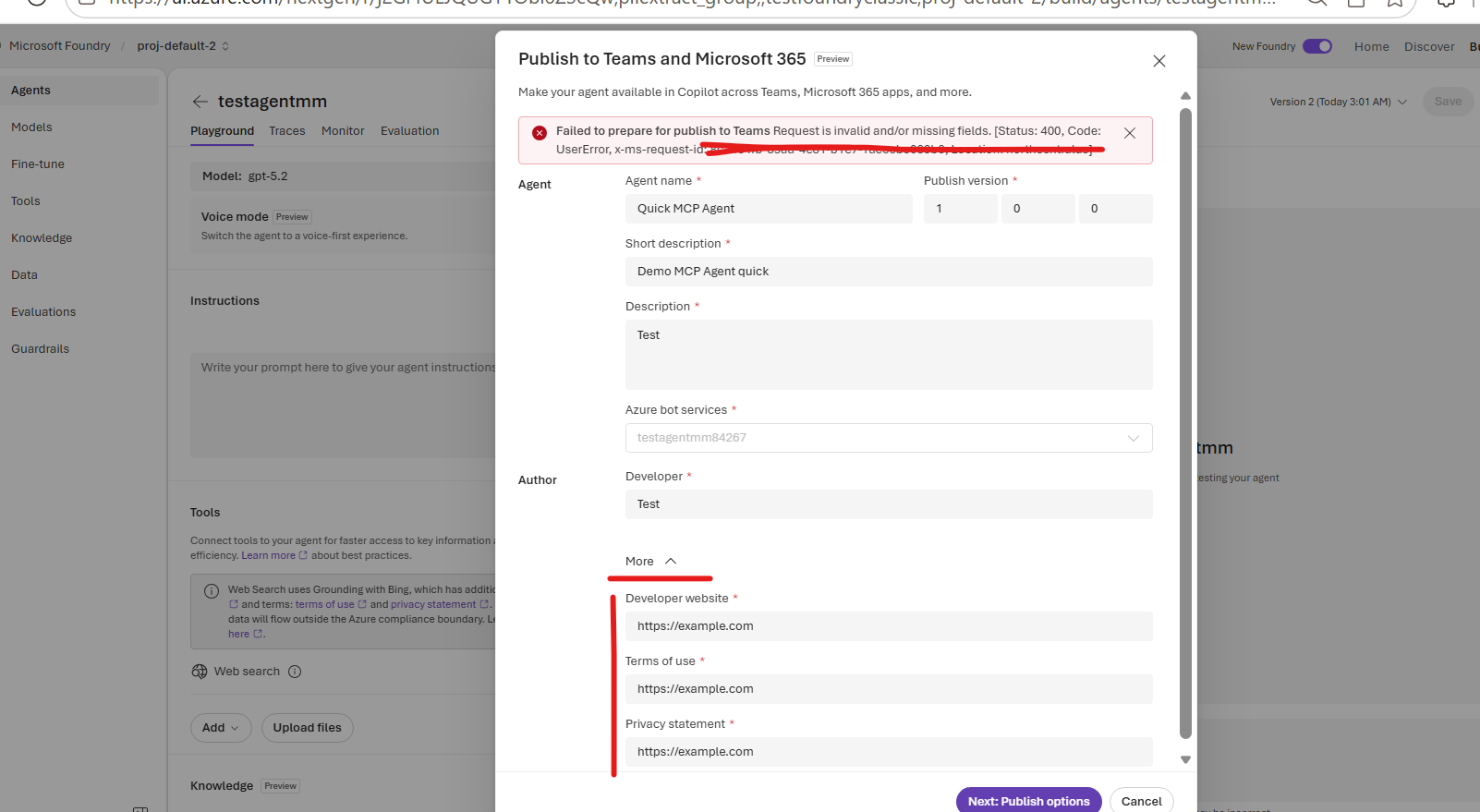

Hello Microsoft Community,
I am using Azure AI Foundry to build an agent with an attached MCP tool.
My setup is as follows:
  • The Azure resource group and the Azure AI Foundry project are located in Sweden Central.
  • The agent was created and tested successfully in Azure AI Foundry.
  • The MCP tool integration works correctly during testing.
  • I now want to publish the agent to Microsoft Teams using the “Publish to Teams” button.
  • A Microsoft Bot Service is configured for this publish process.
  • Since Azure Bot Service / Microsoft Bot Services are currently not available in Sweden Central, the Bot Service was created in West Europe.

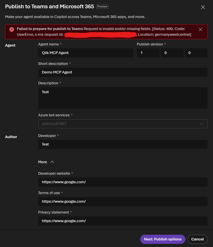

When I try to publish the agent to Teams, I receive the following error:
Failed to prepare for publish to Teams.
Request is invalid and/or missing fields.
[Status: 400, Code: UserError, x-ms-request-id: [REDACTED], Location: germanywestcentral]
Could this issue be related to the fact that the Azure AI Foundry agent is located in Sweden Central, while the Bot Service is located in West Europe?
Is it required that the Foundry project, the agent, and the Bot Service are all located in the same Azure region for publishing to Microsoft Teams?
If not, what configuration could cause this 400 UserError during the “Publish to Teams” preparation step?
Any guidance on the required regional setup or missing configuration would be appreciated.
Best regards, Oskar Note: PII redacted at supported side

Hallo Oskar Kühsel
Sie stoßen beim Veröffentlichen eines Azure AI Foundry-Agenten auf Microsoft Teams auf folgenden Fehler:
"Habe es nicht geschafft, die Veröffentlichung an Teams vorzubereiten. Anfrage ist ungültig und/oder fehlende Felder (400 UserError)"
Du hast auch gefragt, ob dies daran liegen könnte, dass der Foundry-Agent in Schweden Central und der Bot Service in Westeuropa ist, und ob alle Ressourcen in derselben Region sein müssen.

B. Unvollständige oder ungültige Veröffentlichungsmetadaten (höchstwahrscheinlich Ursache 1)
Selbst wenn Felder in der Benutzeroberfläche ausgefüllt erscheinen, kann die Backend-Validierung scheitern, wenn:
  • App-Name, Beschreibung oder URLs sind ungültig
  • Die Entwicklerinformationen sind unvollständig
  • Erforderliche Manifestfelder werden nicht korrekt verarbeitet

✅ Zusätzliche Validierungs-Checkliste
Überprüfen Sie vor erneutem Versuch:
  • Alle Veröffentlichungsformularfelder sind:
    • Nicht leer
      • Gültig (insbesondere HTTPS-URLs)
  • Azure Bot Service:
    • Existiert und ist gesund
      • Hat der Microsoft Teams-Kanal aktiviert
  • App-Registrierung:
    • Hat gültige ClientId, TenantId und Secret
  • (Optional) Testveröffentlichung ohne MCP/Tools zur Isolierung von Problemen
  • Wähle standardmäßig generierte Bot-Dienste, anstatt einen eigenen benutzerdefinierten zu verwenden
