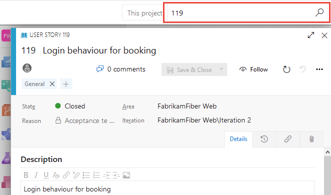

Search by work item ID
Enter the work item ID in the Azure DevOps title bar. You can read and edit the work item in a modal dialog.

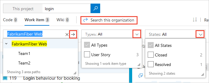

- Search from a project to, by default, search only within that project.
- Search from inside a team to, by default, search only within the default area path of that team.
- Select a project to view a list of area paths in that project for which you have Read access.
- Select area paths in the tree to narrow your search if necessary.
- View hit counts for all projects, even one that you don't select.

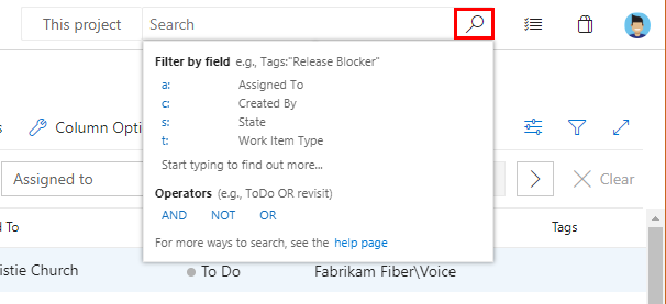

To fine-tune your search, specify fields. Search all assigned items by entering
a:and a user name.
Quick filters:
a:for Assigned to:c:for Created by:s:for Statet:for Work item type

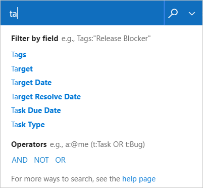

Start entering the name of a field in your work items; for example, enter
ta.
The dropdown list shows work item field name suggestions that match user input. These suggestions help you complete the search faster. For example, a search such as
tags:Criticalfinds all work items tagged 'Critical.'Add more filters to further narrow your search, and use Boolean operators to combine terms if necessary. For example, a: Chris t: Bug s: Active finds all active bugs assigned to a user named Chris.

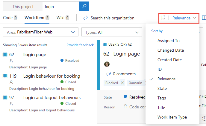

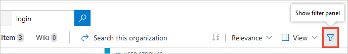

Narrow your search to specific types and states, by using the selector lists at the top of the results page.
Widen your search across all projects, or narrow it to specific types and states. Use the filter to show the selector lists.
Select the criteria you want in the drop-down selector lists, or search across the entire organization.
Sort the results with the drop-down list of field names, work item types, or by relevance.
