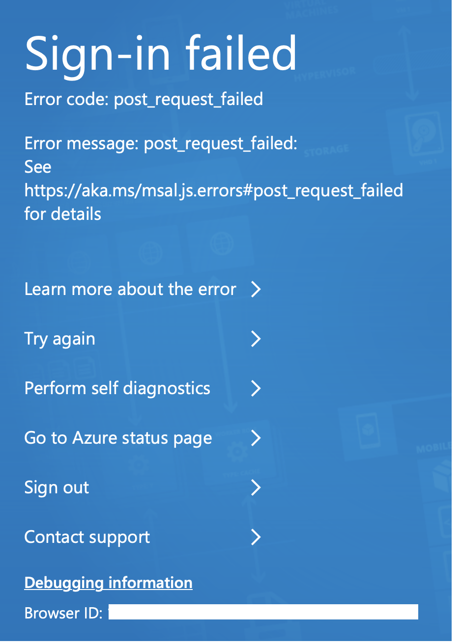

    Thanks for your quick answer, here is the info you requested.
    1. The email is a custom domain. The one I log into here.
    2. I cannot access the Azure platform (I usually get an MFA loop as I do not have an Authenticator profile for that account).
    3. I tried the link you sent and got the following error (see screenshot) Benutzerbild
    4. I've tried using an incognito browser but it doesn't work.
    Additional Info: The "personal" 365 Family subscription is mine and I have full access to it, the "work" account with the same email address was (I believe) set up by a company I used to work with that has now ceased trading. Therefore, I have no access to admin (or Azure) for the work account.
    Any suggestions are very welcome!

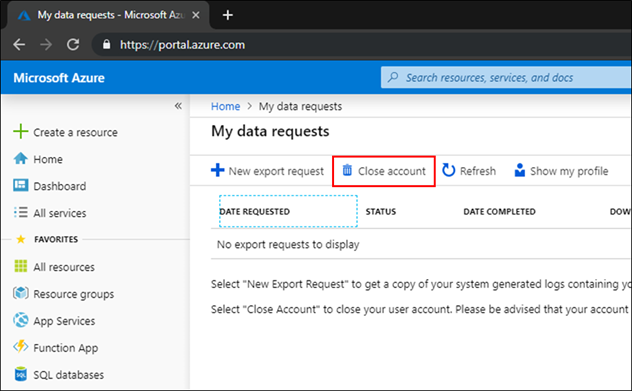

    Based on what you've described, your account appears to be in an unmanaged (viral) Microsoft Entra tenant, which is consistent with the IsViral: true result.
    In this case, users can normally remove themselves by going to My data requests > Close account in the Microsoft Azure Portal via this link: https://portal.azure.com/#blade/Microsoft_AAD_IAM/PrivacyDataRequests
    You may also want to try accessing the portal using an InPrivate/Incognito browser window or a different browser. This can help rule out issues caused by cached credentials, existing sign-in sessions, or browser extensions.
    My data requests - Close account
    For more information, please refer to Close your work or school account in an unmanaged Microsoft Entra organization and Clean up unmanaged Microsoft Entra accounts (You can reset the user redemption status).
    However, if the Close account option is not available or you're unable to sign in because you're locked out by MFA, the self-service process cannot be completed. In that case, I recommend contacting Microsoft Support for further assistance, as they can investigate the account and tenant status in more detail. As a forum member like you, I do not have access to your tenant or account records for further investigation.
    Because you do not have access to the Azure or Entra portal due to Microsoft Authenticator MFA, and also don't have access to the Admin Center, you may not be able to open a support ticket through there.
    In this case, you can try to contact Microsoft Data Protection Support by phone. For a full list of regional numbers, you can also visit this official page: Customer service phone numbers - Microsoft Support. The support team will assist you as soon as possible. For reference:  Get support | Microsoft Docs   
