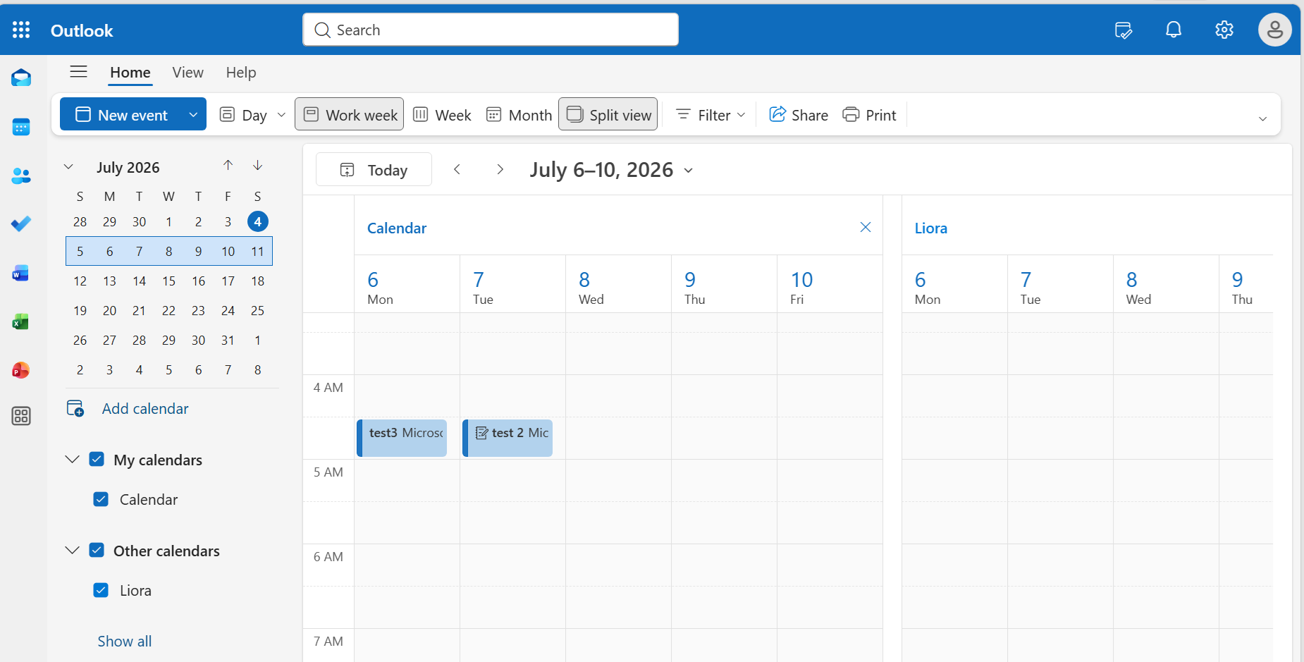

    To better understand the issue, I performed a similar test:
    • Shared an Exchange Online calendar with an Outlook.com account.
    • Accepted the invitation successfully.
    • The calendar appeared under Other Calendars in Outlook.com.
    • Calendar publishing via HTML/ICS continued to display appointments correctly.
    • However, the shared calendar itself did not display any appointments, even after verifying sharing permissions. Benutzerbild
    This behavior is very similar to what you described.
    Based on both your findings and my own testing, the calendar data itself does not appear to be missing because the appointments remain visible through the published HTML/ICS calendar. The sharing invitation is also processed successfully because the Outlook.com account receives the invitation and the calendar is created correctly.
    For reference, Microsoft notes that the modern shared calendar improvements primarily apply to calendars shared between Exchange Online mailboxes. Outlook.com consumer accounts follow a different sharing path, which further suggests that the issue may be occurring in the Exchange Online > Outlook.com calendar sharing flow rather than within the mailbox itself.
    Based on these results, I am concerned that this may be a service-side issue or an issue within the consumer calendar sharing synchronization process. Because the behavior can be reproduced and does not appear to be explained by current documentation, I recommend opening a Microsoft 365 support ticket so that the Exchange Online team can review the backend sharing relationship and confirm whether there is a known issue or service limitation affecting this scenario.
