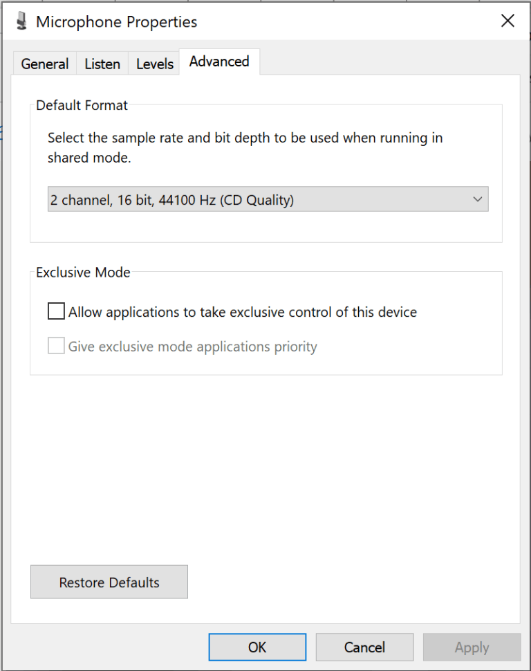

    Ich habe explizit in der Systemsteuerung den Haken raus genommen bei "Anwendungen haben die alleinige Kontrolle über das Gerät" DANN SOLL DAS AUCH SO SEIN!

    After 25 hours forum reading, learning and 2 gin-tonict i'm proud that NT-USB Rode works with Microsoft Teams and Win10. I disabled "Allow applications to take exclusive control of this devices".
    In a test meeting with myself and a recording the sound quality was quiet better and i hope this will still running after getting up tomorrow in the morning.
