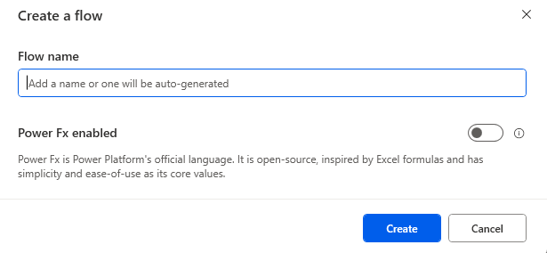

Hi Jana, thank you so much for the update — great job figuring that out! :)
And you're right, Jana! The issue was caused by Power Fx being enabled. With Power Fx, it uses ${CurrentItem}[0], but without it, it uses %CurrentItem[0]%, which works correctly in your flow.
So yes — turning off Power Fx fixed the problem.
Hope it helps, please let me know if you need further assistance.

  1. Anonymní
    2025-06-25T11:31:19+00:00
    Hi Arlene,
    I found the issue... :)
    When I created a new flow, I had Power Fx enabled.
    Then the variables was like with = or with written like this: ${CurrentItem}[0]
    When I have Power Fx not enabled, then it is like this: %CurrentItem[0]%.
    And in this way it works without setting text variable.
    So this was the problem, I mean.
    Jana

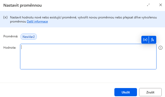

  2. Anonymní
    2025-06-25T10:24:21+00:00
    Hi, Jana! Thanks for getting back to me.
    In the Hodnota (Value) field, just type this:
    %CurrentItem[0]%
    This gets the first column from your Excel row. If you need a different column, just change the number (e.g. [1] for the second column).
    Then use your new variable (NewVar2) in your script like this:
    .text = "%NewVar2%"
    That’s it! Let me know if you’re not sure which column number to use.

    This is the window for set variable (as you wrote I should use):
    Here to the value field should I write this?
    string(items('Apply_to_each')?['YourFieldName'])
