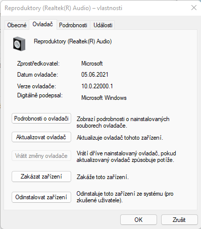

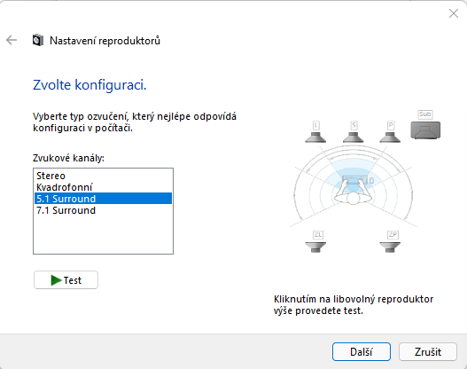

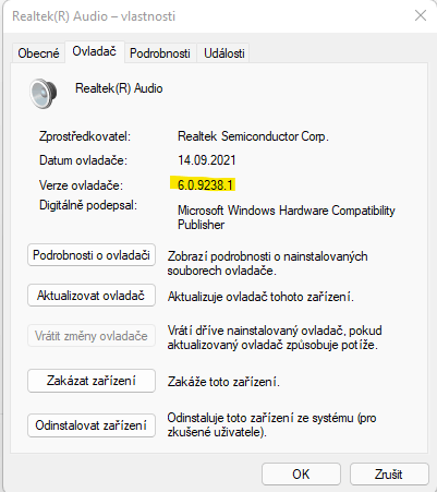

I have a new ASUS - TUF-GAMING-H570-PRO and applications does not play on my 5+1 speakers. I have installed newest ASUS Audio driver and during the test all speakers play.
Picture shows driver for sound and movies and follow picture of driver for sound input and output.
The Realtek Audio Console shows the 5+1 configuration and if I click on the speaker it play the one speaker which was clicked.
In the mmsys.cpl the speaker test works fine and all speakers play.
But if I run a music stored in MP3 format or the movie, only stereo (front speakers) play the sound. The rear speakers, center and subwoofer speaker are muted. If I play the DVD the only Center speaker play.
I tried uninstall the sound driver without success. I did the factory reset of Win 11, but the same behavior. Sound test works on 5.1 speakers, but in application play only stereo.

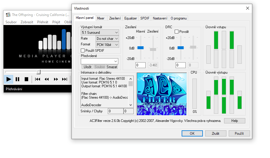

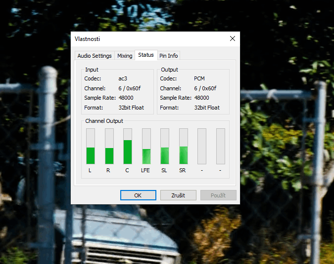

Anonymní
2022-01-22T17:55:15+00:00
Pořádně si to nastavení poštěluj. A pokud to nepude, zkusil bych to být tebou projet přes ac3filter (i ne ac3 audia) (obr.1 - mpc-hc + ac3filter... stereo flac puštěný na 5.1).
Něco tam máš asi blbě nastavené (mpc-hc a interní lav (bez ac3filtru)): obr2.
... a to mám doma jen stereo repráky a sluchátka a o 5.1 se nezajímám :-)
Obrázek
Obrázek
